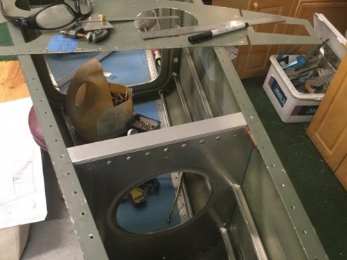

Brief Description:  Aft Fuselage Repair
Installed F-710B with 7 of 11 rivets. The outboard two on each side will require the use of an offset rivet set, and I’d prefer to use that set with both hands and a helper to buck.
I also fabricated, fit, and deburred the edges of the F-710C spacer.
Rivets Today: 7
Rivets Total: 11973
F-710C in its final resting place.
