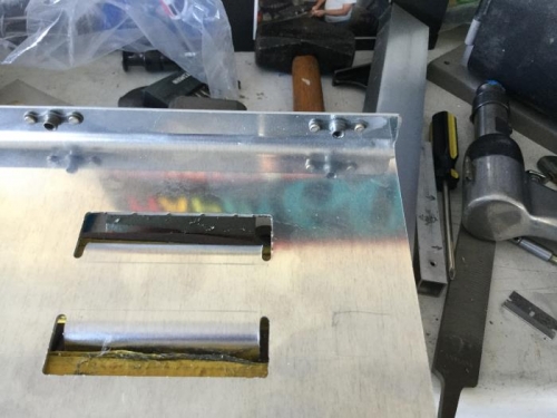

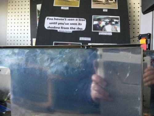

Enlarged 4 screw holes to #19 and installed four K-1000-08 platenuts each to the F-782C center cabin cover and F-7115A bottom cover where they attach to the F-772B-L&R floor stiffeners. Deburred edges of F-7115A bottom cover.
