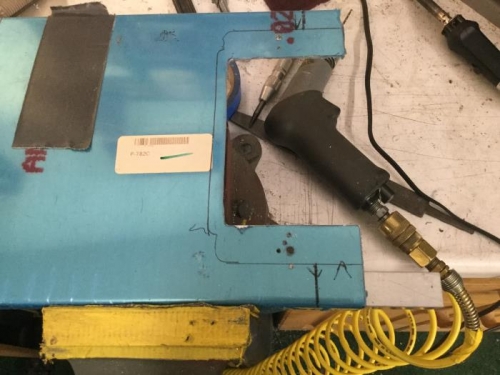

High Pressure Fuel Pump
I cut the big notch in the F-782C for routing the pump plumbing, enlarged the screw holes to #19, and drilled for nut plates.
Not worried about the mislocated screw pilot holes.
