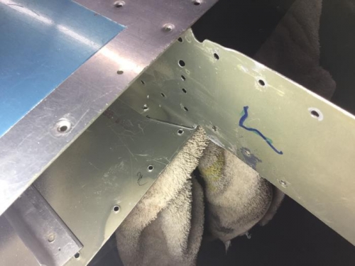

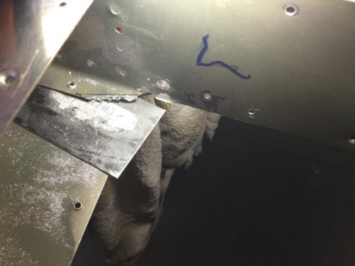

Step 10 continued. Even with a 1.25” cutoff disk on a Dremel Micro, I couldn’t finish trimming the corner of the HS-702 spar flange with a cutoff wheel (as called for in the instructions) due to interference with the inboard section of the web. I ended up using a 1/16” diameter burr in my Dremel Micro. I added a 1/8” thick aluminum shim behind the flange to hold it off of the stainless, which allowed me to us the edge of a mill file to smooth the ragged edge left by the burr. I started deburring the edge and making the radii with a flat needle file, the finished smoothing the edges with 360-grit sandpaper.

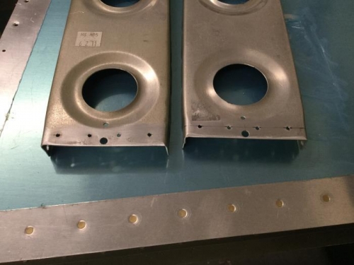

Step 11. There is no step that says to cut the forward flange off of the HS-405 ribs, but it’s very obvious that it needs to be done before radiusing.
Step 12. Marked, drilled, and deburred the four pilot holes in the forward ends of the HS-405 main ribs as shown in Figure 5.

After cutting with a small burr. Note that the flange is shimmed up from the skin.
After Filing and Deburring
HS-405 Ribs Trimmed, Radiused, and Drilled
