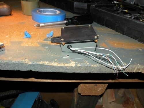

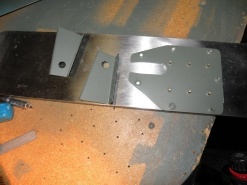

I dimpled the trim servo mount parts -3 for the rivet holes, #6 for the screw holes, riveted the flanges to the cover, and installed the servo on the mount. Just to verify my previous fitting, I was able to get the assembly in the elevator, but I didn't screw it down because I want to drill a hole in the spar separate from the one used to acommodate the servo shaft, most likely centered on the hole already in the elevator horn weldment.

Trim servo mount parts dimpled and ready for back riveting.
Trim servo mounted.
Trim servo mounted.
