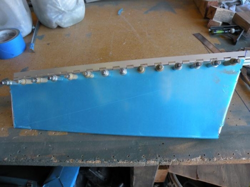

I fitted and drilled the aft half of the hinge to the trim tab and marked the outboard edge for later trimming. I marked the rivet line on the hinge 3/16" from the edge so the holes would have minimum edge distance in the locations between the barrels. I taped the trim tab with hinge in place into the elevator opening, and this seems to be a good location. While the trim tab was still assembled, I drilled the rivet holes for the closeout tabs on both ends.

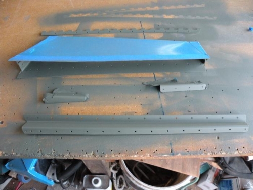

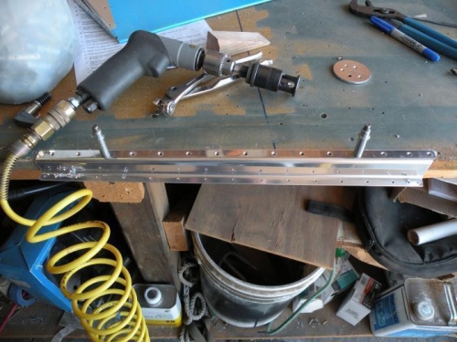

I then disassembled the tab and deburred all holes and edges. After countersinking the trim tab spar, I masked, scrubbed with Dawn and Scotchbrite, solvent wiped, and primed the five trim tab parts. I'll let the primer cure for at least a couple of days before dimpling and riveting. I can rivet the left elevator in the meantime.
Trim tab hinge drilled to trim tab skin and spar; inboard end marked for trimming.
Countersinking the trim tab spar.
Priming complete. I'll let it cure for at least a couple of days before dimpling and riveting.
