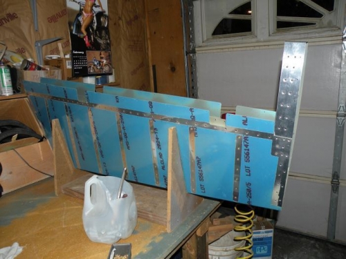

Per the instructions, I riveted the right counterbalance to the main skin before inserting the skeleton, using two rivets each, top and bottom. These particular rivets are set now, as they would be inaccessible after inserting the skeleton and would require blind rivets.
I think the right elevator is ready for riveting the skin to skeleton. The only possible exception might be the removal of some of the lead from the counterweight. The instructions have the lead weight installed loosely before inserting the skeleton in the skin, but if the counterweight can be installed after the skeleton, I'll wait to remove the extra lead after riveting. If not, of course, I'll trim the counterweight before riveting.

Two rivets top and bottom holding the counterbalance skin in place. Ready for the skeleton!
