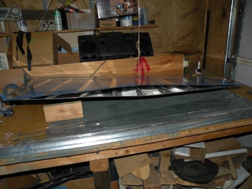

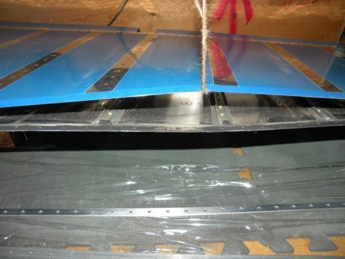

Prosealed the trailing edge of the rudder. I didn't have help, so stealing an idea from another builder, I held the skins open with a piece of twine suspended from a rafter, as shown in Photo 1. The weight of the rudder opens the skins just enough to get in for scuffing, cleaning, and insertion of the AEX wedge. I couldn't find my stainless steel brushes, and scotchbrite didn't get the surfaces rough enough to suit me, so I used 100-grit aluminum oxide sandpaper to scuff the skins and AEX wedge. I then solvent wiped several times until the rag came up clean.

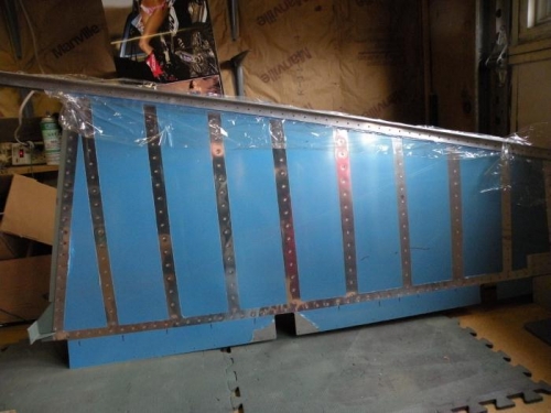

I applied the proseal with an acid brush trimmed down to 1/4 inch, which made the brush stiff enough to spread the proseal into a fairly thin layer. I applied the first layer to the bottom skin, as shown in Photo 2. Next, I inserted the AEX wedge and applied a layer of proseal to the top of that, then 100% clecoed the two angles through the whole assembly. Hopefully this will result in a very straight trailing edge with no pillowing between rivet holes. I moved the assembly into the (warm) spare bedroom for a couple of days to allow the proseal to cure.

Working solo required stealing an idea from another builder.
First layer of proseal applied to bottom skin trailing edge.
Trailing edge gluing complete and 100% cleoed between two angles.
