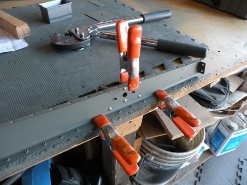

Next up on the rudder was riveting the spar reinforcements and nutplates to the spar. On the upper two plates I was able to reach all rivets with the squeezer using the 1.5" C-yoke and the longeron yoke.

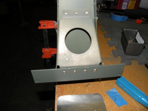

As on the Rocket 14 years ago, riveting the bottom of the rudder brace to the rudder horn was pretty much a non event - thanks to the longeron yoke. The fit was tight enough that I had to open up the adjustable set holder wider than required, put the nose of the yoke in the brace, then readjust the holder. A bit tedious, but all 4 rivets set properly on the first try.
