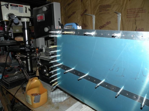

Riveted both HS-707 center nose ribs to skins. I found this easier to do with the skins standing on end as shown in Photo 1 as opposed to laying flat per the instructions.

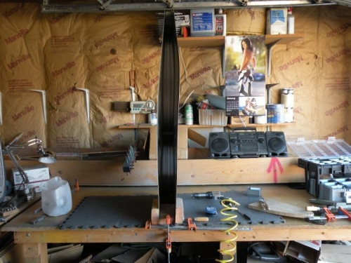

Clecoed both front and rear spars in place in the skins and checked elevator hinge hole alignment by placing a flashlight at one end and sighting it through the other. Perfect! I tried to get a photo through all the hinge holes, but couldn't get the camera lined up.

Skin standing vertically for riveting the HS-707 center nose rib.
LED flashlight shining through elevator hinge holes.

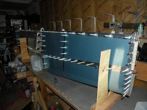

HS completely assembled. Ready to rivet after removing rear spar.
