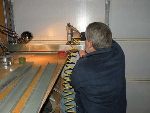

Tonight I dimpled all ribs and spars for both the horizontal and vertical stabilizers, the rudder spar, and the right horizontal stab skin.

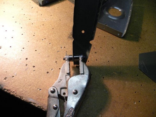

To dimple the spars and ribs I set up my pneumatic squeezer with Cleaveland tank dies. Dimples made with tank dies are a few mils deeper than the skin dimples made with standard dies, which helps the skin fit better to the ribs and spars. The HS-706 and VS-706 tip ribs are too narrow at the nose to fit around the yoke/female die combination in the pneumatic squeezer, so I used the tank dies in my vice-grip dimpler as shown in Photo 2.

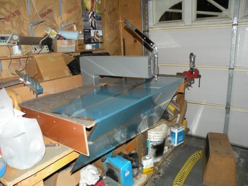

To dimple the skins, I set up my DRDT-2 dimpling tool and dimpling tables as hown in Photo 3. While I was waiting on the empennage kit to arrive last month, I made the dimpling tables from about $5 worth of surplus laminate flooring, along with about another $5 worth of indoor/outdoor carpet. The sides are connected to the top through pieces of 2x2 lumber I found in the hangar. I clamped the DRDT-2 to the lip of the workbench with a couple of 1" C-clamps, while each of the table halves are independent and free standing. This makes the whole set-up removable in just a couple of minutes to free up the workbench as required. I need to cut the corners back on the outboard table sides like I did with the inboard sides so that a folded skin such as this one will have less interference with the table. As mentioned before, standard dies are used to dimple the skin to enable a better fit in the understructure dimpled with tank dies.
It was getting late, so I only got the one HS skin dimpled tonight. After the other HS skin and the VS skin are dimpled (tomorrow I hope), those two assemblies will be ready to rivet!
Me dimpling one of the HS forward spars with my pneumatic dimpler.
Vice grip dimpler needed for fwd end of tip ribs.
DRDT-2 set up to dimple right HS skin.
