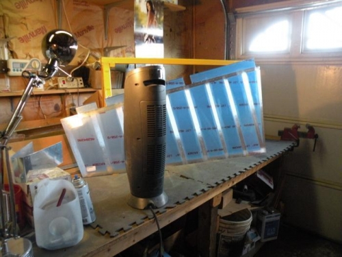

The outside temperature dropped about 30 degrees from yesterday, so priming outside was out of the question. I set up in the garage and used the 1500W heater Karen got me for Christmas to warm the parts for priming. I'm keeping the Duplicolor self-etching primer in the house until time for sprayng.

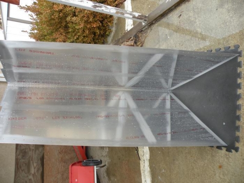

The water sheeting off of the scuffed surfaces indicates adequate cleaning for primer adhesion.

Scuffed and cleaned left rudder skin warming in front of the heater in preparation for priming.

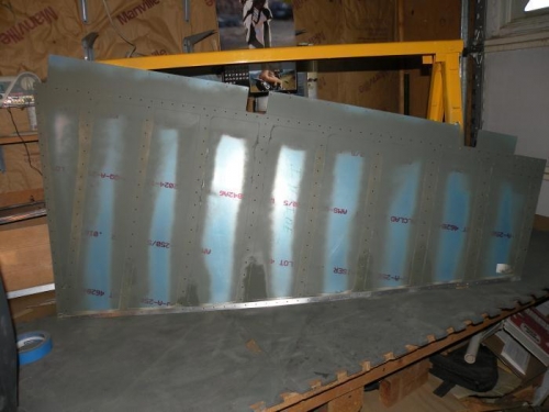

Primed right rudder skin. The dark patches are still wet.
