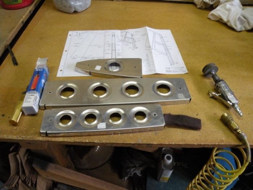

Brief Description:  Today's Task 1 - Edge Deburring VS Parts.
Deburred edges of the VS ribs, (including lightening holes) and spar doubler. I had planned on using a small scotchbrite wheel in my die grinder to debur the lightening holes. I couldn't find a 1" wheel, and my 2" wheel is too large for these holes. I ended up using my Shaviv edge deburring tool to scrape the insides of the holes. At first this was leaving "chatter" marks, but slowing down the speed solved this problem. I finished off the holes with maroon scotchbrite.

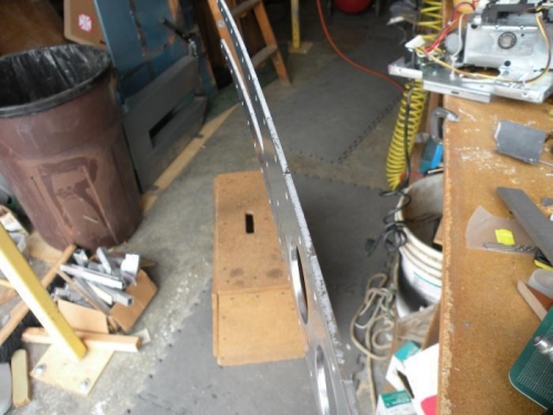

Next up was the VS-803PP spar doubler. This piece is about 1/8 inch thick and had some pretty gnarly punch marks both on the outside edges and inside the 7 lightening holes. For the lightening holes (and the inside radius of the fork), I used a small round needle file held in both hands and made about a hundred revolutions around the inside of each hole to take out the punch marks. I removed the file marks with 100 and 220 grit black oxide sandpaper, then finished off with maroon scotchbrite. I broke out the vixen file for the outside edges, and finished those up with the 2" scotchbrite wheel.

Getting ready to debur lightening holes in VS ribs.
Gnarly punch marks on the spar doubler.
Punch marks removed with the vixen file.
