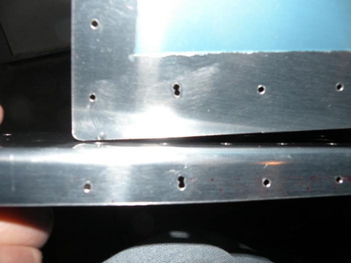

Oh yeah, this is supposed to be about building an RV-7... While at the hangar this morning to retrieve my ladder to work on the garage door, I found my favorite hole deburring tool, so I got started with that. I deburred ALL holes in ALL parts of the horizontal stabilizer, including spar channels, reinforcements, hinge brackets, ribs, and skins. I kind of dreaded the skins, but knocked them out in about 30 minutes each. I also final drilled the replacement HS-412 hinge bracket that I inadvertently drilled oversize on the second day of the project.
I also deburred the edges of the rear spar channels. All other parts except the skins had been edge-finished previously. I still have the skins to go to be completely done with deburring on the HS.
The photos show a couple of problems discovered during deburring. Photo 1 shows a figure-eight hole on the lower inboard corner of the left HS skin and rear spar. I have no idea how this happened; I didn't even discover it until dissassembling for deburring. I suspect the fix will be to add a rivet to the spaces on either side of the bad hole. I'll contact Van's for confirmation.
EDIT 1/3/12: Scott at Van's said the intermediate holes are fine.

Bottom Inboard Rear Corner of Left Horizontal Stabilizer.
