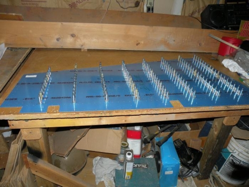

Fabricated Rudder Stiffeners and Drilled to Skins
Fabricated R-915A-H rudder stiffeners for left and right rudder skins.
Finished edges of all rudder stiffeners.
Drilled stiffeners to both skins. I do the drilling, and Karen does the clecoing. Together, we knocked out the drillng in about 20 minutes per skin.

Stiffeners drilled to inside of R-901-R right rudder skin.
