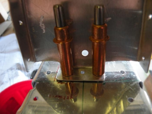

Upon disassembly I found an edge distance issue on both HS-404 inboard nose ribs. The bottom hole on both ribs was approximately 3/16" (1/16" too close) from the bottom edge of the rear flange on both ribs. The distance between the two hole in the flange was 7/8" on both ribs, so I added a third hole exactly halfway between the original two.

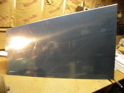

After dissassembly, I stripped the vinyl from the rivet hole lines on both HS skin and the VS skin. In preparation for assembly, I also stripped the vinyl completely from the interior of both HS skins.

Edge distance issue resolution.

An HS skin with the vinyl removed from the rivet lines.
