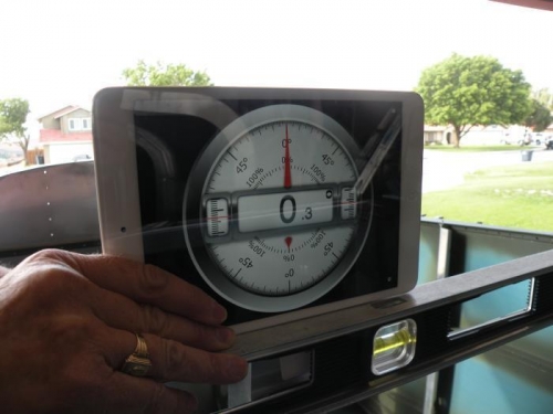

I then proceeded to check the fuselage for twist. I used an inclinometer app on my iPad mini to measure the angle (relative to gravity ;O) ) across the longerons at the F-704 bulkhead, and at the F-710 bulkhead with the aft deck in place but not clamped. The iPad inclinometer is somewhat sensitive to the vertical angle of the iPad, so I backed it up with a wide angle so the vertical angle was consistent between the forward and aft measurements. The F-704 bulkhead measured about 0.3 degrees, left side low, and the aft deck measured 0.6 degrees aft deck low. To remove the 0.3 degree twist, I clamped an angle across the horizontal stab attach bars for leverage with one hand, and tightened the clamps with the other while Karen held the iPad in position. Photos 1 and 2 show the forward and aft fuselage angles after tightening the clamps. They are parallel, so I'm calling it good.

F-704 is 0.3 degrees, left side low.
The aft deck is PARALLEL to the F-704!
