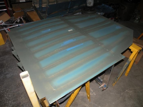

One hour flat to scuff, clean, and prime the interior faying surfaces of the center bottom skin (see photo). Looking at my old skin, I noticed that I'd primed the narrow section outboard of the fuselage that underlaps the wings. After all, that will be a faying surface when the wings are installed. I'll take care of that on the new skin the next time I do some priming.
