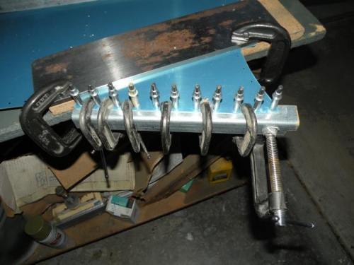

Not having much luck with the method George Orndorff demonstrates in his video, I tried the method described in the instructions on the right skin. Instead of using an aluminum angle I used a piece of the 1x1x1/8 steel angle I used to keep the trailing edge of the rudder straight. I used a 3/32 drill rather than a #40 to keep the holes as small as possible, as I had heard of at least one builder that had the clecos pull through. Well, when I started the bend, the forward half of the clecos unzipped so loudly, I thought I had torn the corner completely off the skin. Fortunately, the noise was just the clecos pulling through the steel angle, and there was no damage at all. After I re-clecoed and added clamps (photo 2), the bend went pretty much to plan. I did have a crack in the forward end of this bend as well, although a bit shorter than the one on the left side. I'm thinking about adding an AN470-4 rivet to nowhere on each side just so the holes look like they're supposed to be there...

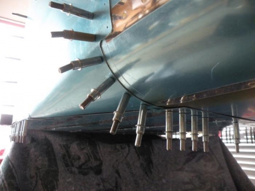

Even though the aft end of the bend on the right skin looked slightly uneven, it fit the aft curve fairly well and pulled in easily as it was clecoed (photo 3).

This the set up that worked.
Right side skin after first try at the shape of the bend
