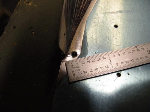

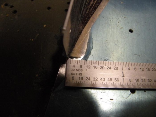

Not much time again tonight, but I did get the roll completed in the lower aft corner of the left forward side skin... at the expense of a 1.4-inch crack! I stop drilled it to #30 and deburred. I'll send a photo to Vans and see what they say...
OOPS! A 1/4-inch crack...
Stop drilled and deburred.
