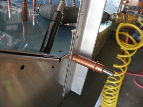

I started today by drilling the right outboard F-715 seat rib to the F-704 and the side skin. I then removed the side skins, and match drilled the top flange of the outboard seat ribs through the floor pans, using the method suggested in the instructions (photo 1).

Positioning the rib flange for drilling through the seat pans.
