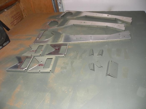

After getting all the fab work done on the aileron trim, I prepped and primed the parts I didn't get to during the last work session, including ribs, spacers, and brackets, including the one for the aileron trim. I'll give these a couple of days to cure before dimpling and riveting.

The last center fuselage parts (for now) prepped and primed.
