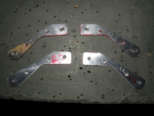

I finally decided to modify two more seat ribs (the second from inboard on both sides), so the control column can be mounted with the sticks and interconnect rod already installed.
I started by tracing the original F-716B straps on a left over tank close out plate (0.062 thick). I laid them out so that each one made use of an existing #8 screw hole (photo 1). After rough cutting them on my bandsaw, I cleaned them up on my belt sander and scotchbrite wheel. I then match drilled them to their respective ribs, and countersunk the rivet holes (photo 2).
I then modified the ribs themselves. On the first two I missed the tip in the plans to drill a 1-1/2 inch hole at the top of the cutouts, and snipped them out by hand. They came out OK, but were kind of tedious. This time I set up my flycutter for a 3/4 radius to cut the top of the lightening hole to 1-1/2 inches, then snipped out along the straight line between the existing hole and the new hole. I then cut out the removable section on my bandsaw, and then deburred all holes and edges.

I traced the original straps on a left over tank closeout plate.
The bottom straps are the new ones.
