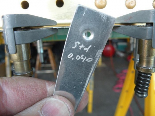

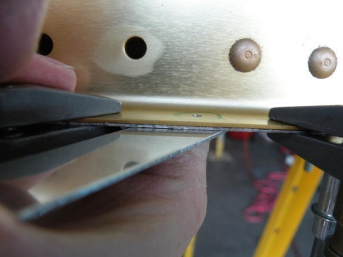

I then fabricated an 0.040 dimple coupon with standard 3/32 dies so I could properly set the countersink depths for the four holes where the floor stiffeners attach (photo 2). After setting the countersink depth (11 "clicks" deeper than for a rivet) on a piece of scrap and checking it with the coupon, I countersunk 4 holes in the F-776 bottom skin and F-704A flange. The fit looks great! The dimple coupon fits flush against the skin, and there's no sideways play (photo 3).

Dimple coupon for standard dies in 0.040 material.
Great countersink fit!
