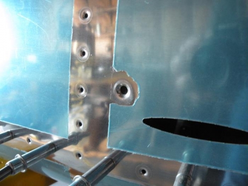

The second thing I noticed that I hadn't yet accomplished was drilling and dimpling the holes for the #8 screws for Adel clamps that secure rudder cable guides just forward of where they exit the fuselage (photo 1). I had to completely uncleco the F-710 bulkhead to get my dimple die bucking bar square to the skin, but it sure beat having to completely remove the side skins for dimpling in the DRDT-2.

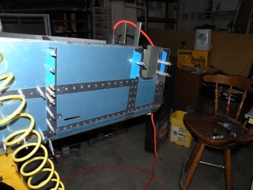

After taking care of those two oversights, I got the aft fuselage completely riveted up to but not including the F-710 bulkhead (photo 3). The instructions have you not rivet above the upper J-stringer so the side skin can be pulled back for dimpling after drilling the main longerons.

Almost missed dimpling this hole...

A good start on riveting the aft fuselage.
