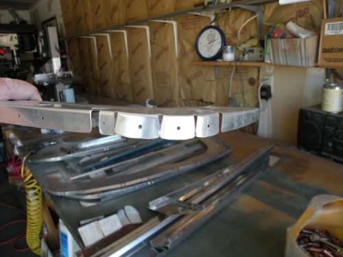

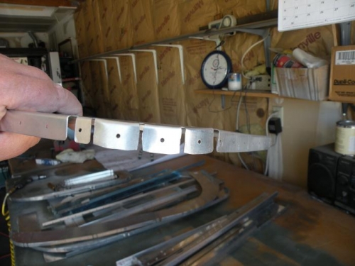

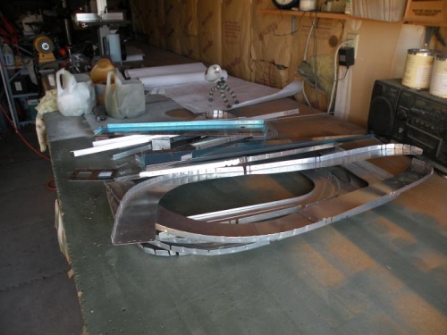

Today I edge and hole deburred the aft fuselage bulkheads. I also fluted the top corners of the F-706, 707, and 708 bulkhead. The tabs on the bottom corners of the F-706, 707, and 708, and the top corners of the F-707 bulkhead halves overlapped and required trimming with my sheet metal shears (photos 1 & 2). All aft bulkhead sheet metal parts are now ready for scuffing, cleaning, and priming of the faying surfaces. I'll completely scuff, clean, and prime the non-alclad parts.
