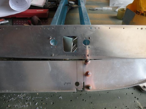

I had some time left in the day, so I got started on the F-706 bulkhead by locating and drilling the electrical and static line passthroughs to full size (photo 1). I then fabricated the three angles that stiffen the elevator bellcrank support structure.

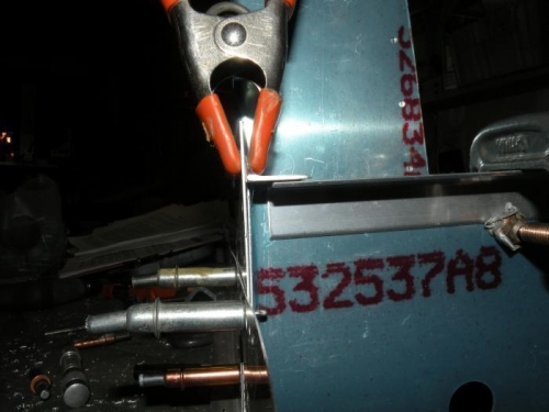

The plans show one hole drilled in the F-729B stiffener for the bellcrank rib (the horizontal angle in photo 2), and I thought it was the starter hole for drilling the stiffener to the bellcrank rib. To test that theory before drilllng the rest of the holes I clamped the structure together (photo 2). As is evident, this arrangement would leave practically no edge distance for attaching the stiffener to the F-729C short span wise angle that ties into the reinforcement plate.
I now think the one hole called out on the plans is supposed to attach the stiffener to that span wise angle. I went back out to the shop and tested my new assumption, and found that this arrangement works on the forward end, but leaves only about a 1D edge distance at the aft end of the bellcrank rib stiffener. I need to give this some more thought...
Electrical and static line passthroughs in the F-706 bulkhead.
This definitely won't work.
