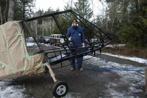

Brief Description:  Spray cockpit
Got a big propane heater going to warm the airframe up and then wheeled the plane onto the driveway to spray a thin coat of Vari-Prime. Worked great and then a few hours later put a thin coat of semigloss black. Put it back into the heated garage to cure.
