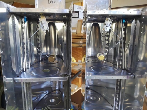

Brief Description:  Install fuel senders
With both tanks complete excepting the rear baffle, I installed the fuel senders. I am using the stock Vans units.
A little tweaking in the wire position to get full travel of the senders to within 1/8" of the top and bottom of each tank with no interference completed the task.
Next step is to add the rear bulkhead finishing the tank assembly
Fuel level senders installed and adjusted
