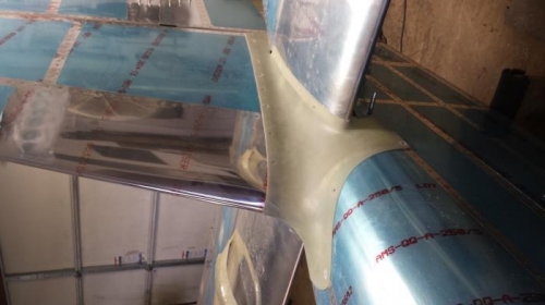

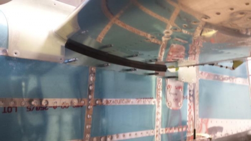

In preparation to raise the fuselage high enough to install the gear, the empennage fairing needed to be completed. This included the gap seals under the stabilizer.
About 45 nut plates were drilled, counter sunk and installed. Once located it is easier to complete the task with the fin, rudder, elevators and stabilizer removed, these were sequentially removed after drilling was complete. As this involved removing the elevator trim cables (that were a royal pain to install) I discovered in the last update of the VPX, I had disabled the pitch and roll trim inputs. To correct that little issue involved about 2 hours and two computes since, for some unknown reason, my new computer wouldn’t connect to the VPX. Another handy computer did the trick.

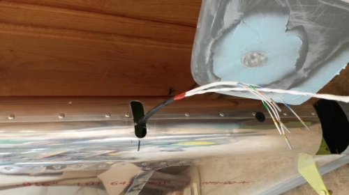

I also took this opportunity to do some rerouting of the trim and strobe wires into the rudder. They needed to absorb the flexing of the rudder movement without fatigue. Any movement will now be slight and spread over 6 inches of length. I also added some filler to the fairings while they are easy to access and sand.

empanage fairing
empanage fairing
stabilizer gap seals
rudder wire routing
rudder wire routing
