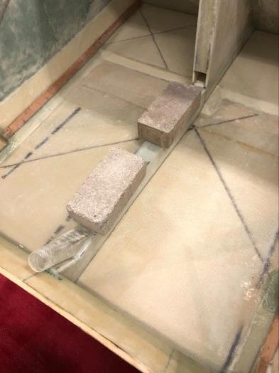

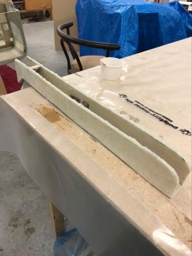

Installation of the aft heat duct:
Workshop temperature 22 deg C and humidity 35%. A batch of flox was mixed using 54g resin and 21g hardner.
Flox was applied to the bottom of the heat duct and to the fuselage where required.
The heat duct was positioned in place and weighed down with bricks. Excess flox was removed from around the sides.
