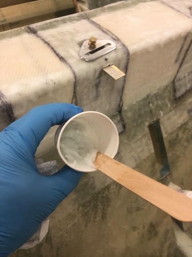

A small batch of flox was mixed using 16g resin and 6g hardner along with some flox.

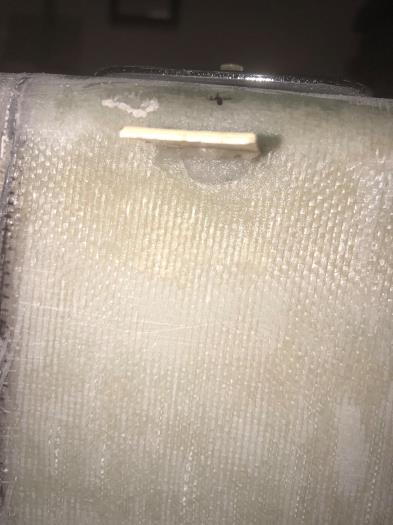

The four aluminum tabs were flox'd in place.

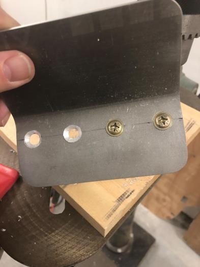

Four 1/4" holes were drilled (and countersink) into the aircraft step.
