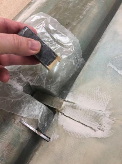

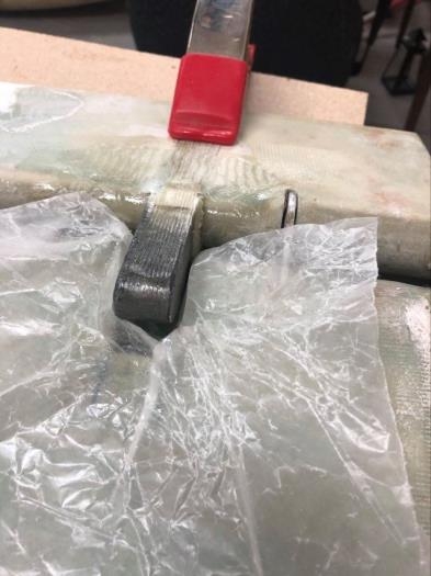

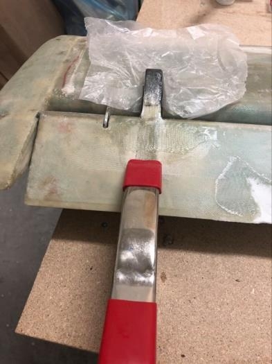

The right outboard mass balance was detached from the canard when I received it from Edmonton. I placed wax paper under the existing UNI strap and mixed a small batch of epoxy and dry micro.
I added dry micro to replace any missing foam between the foam piece on the mass balance and the foam remaining on the right elevator.
I used a 1" brush to apply epoxy to the UNI strap and to its interfacing locations on the mass balance and elevator. I used a clamp to hold the mass balance and UNI strap in position during cure. A single layer of BID cloth was applied over the UNI on the elevator to hold the UNI strap in place.
