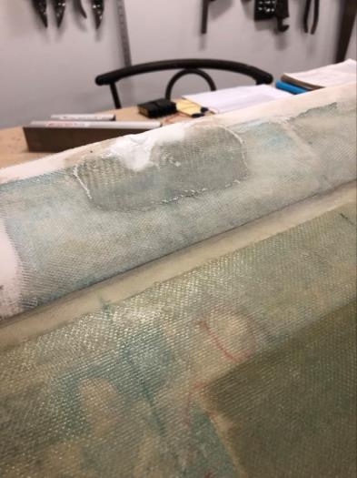

More sanding of rough spots along the top side of the canard.

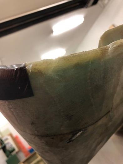

Began the left tip repair with a small BID patch on the bottom of the tip over top of a crack.
Dry Micro was mixed and divets were filled in along the canard.
Left Tip
