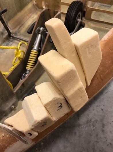

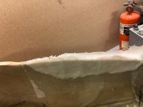

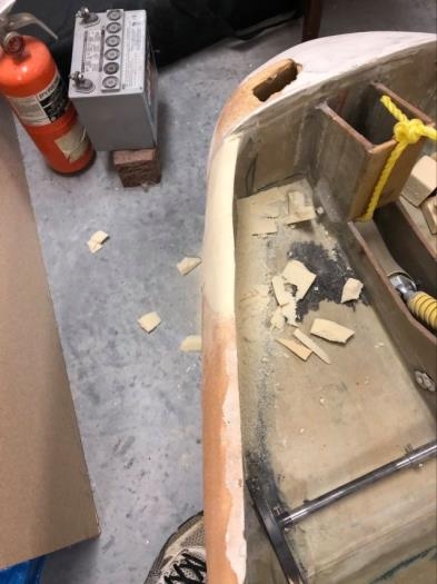

Cut out the bent and delaminated fiberglass and removed the corresponding foam from the front top left of the fuselage.
Used 5-min epoxy to insert foam blocks in the gap.
Cut and sanded the blocks to shape.
Applied micro, 2 layers of BID cloth, and peel ply to the interior side of the repair.
