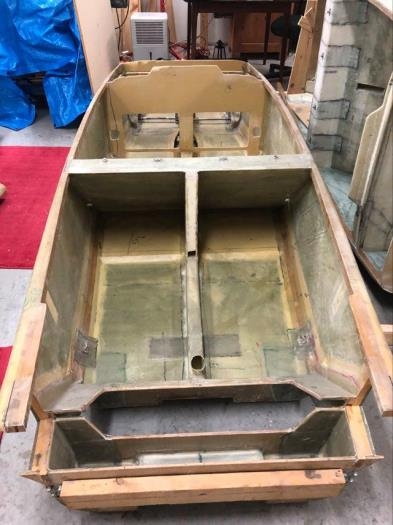

The new project had a few hangar and road rashes needing minor repair.
The fuselage interior was cleanedup and vaccummed. The right rear electrical channel still had foam in it so that was removed.

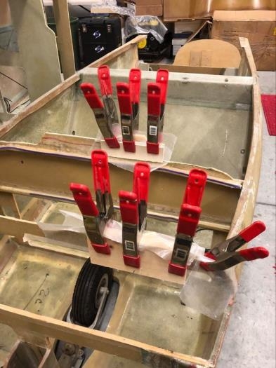

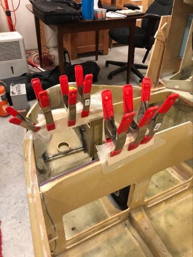

The older and loose foam was removed in the areas that were damaged on the top left of the instrument panel and on the left side of bulkhead F28.
New foam and micro was applied to the areas needing repair. Workshop temperature was 74 deg F and 64% humidity.
Fuselage cleaned up
