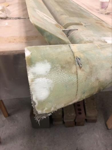

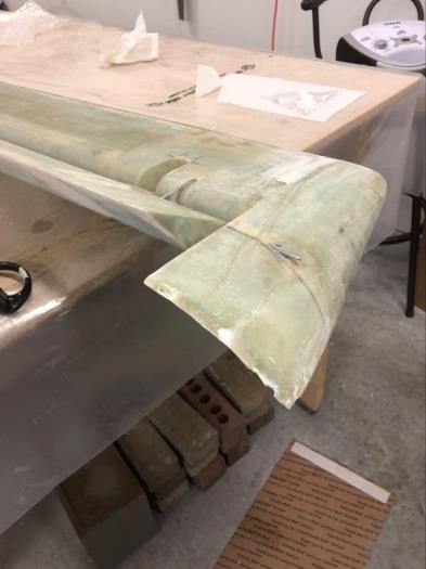

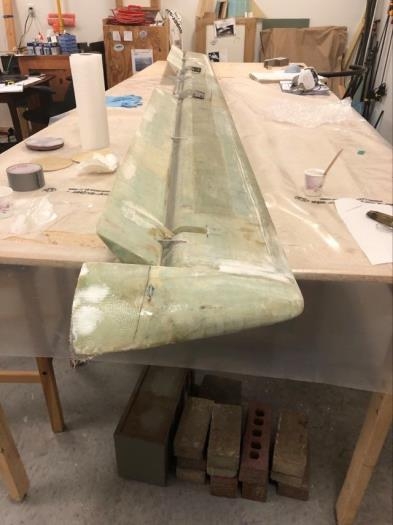

Left fairing repairs continued
The left fairing was sanded on both sides. Dry micro was added to fill some valleys on the bottom side of the fairing. One ply of BID cloth was applied to the top of the fairing on the back side to replace material that is missing.
