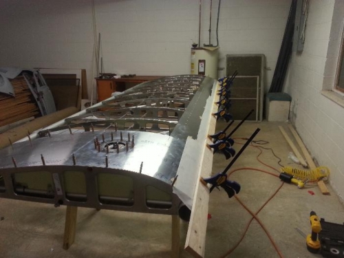

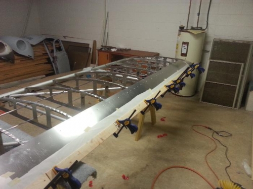

Attach leading edge skin
Rivet leading edge wrap stringer to leading edge wrap, sand bonding areas on leading edge wrap and root skin, sand front and rear spars at bonding area. Bond leading edge wrap and upper root skin with DP460 adhesive.
