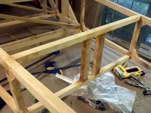

Brief Description:  Cut and glue diagonals, STA 168 3/4
Glued in Sta 168 cross members, and removed, and recut Sta 134 one inch uprights and reglued them in proper position. I had misaligned them originally and was unhappy with the fit and finish. They are 1 1/2 " (3/4 off cnter line) as called by the plans. A tricky cut was required to match up the fore and aft angles for proper glueing surface.
