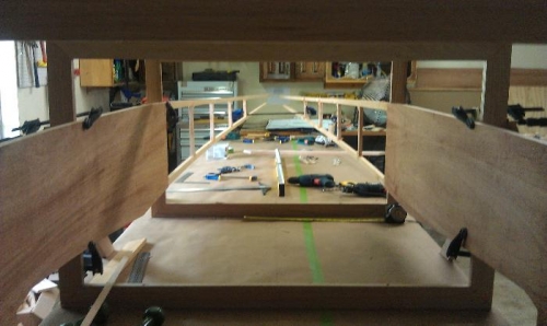

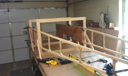

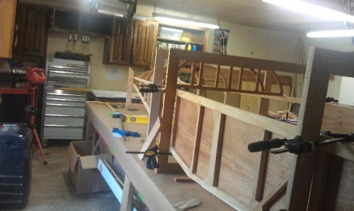

Brief Description:  begin building construction jig frames
The fuslage sides jigged upright in frames assembled from 1/2 inch plywood cut in strips and glued together. I went a bit further and used 1 ich by 3 inch oak for the frames. I lofted the top view of the fuselage to fresh paper and started building frames. These were mitered at 45 degrees assembled in 90 degree corner clamps to ensure they were true. I built two, One placed aft of station 0 slightly and the 2nd aft of station 42. I decided to install the fuse sides and build each additional frame as I needed so to match the plans dimensions. The plans state that the only 3 deminions that are critical are the Station 0, Station 97, and Station 178
The frames where clamped into station 0 and 42 and leveled
