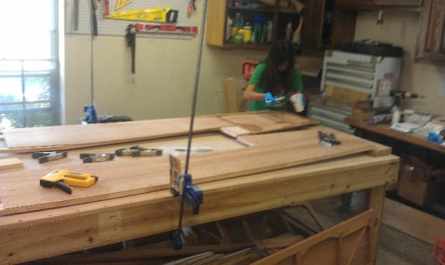

pre-curve the fuselage sides
From consulting the newsletters it was advised to pre curve the fuse sides while attaching the ply. The ply is secured to the spruce members with staples and they are removed after the t-88 epoxy dries
