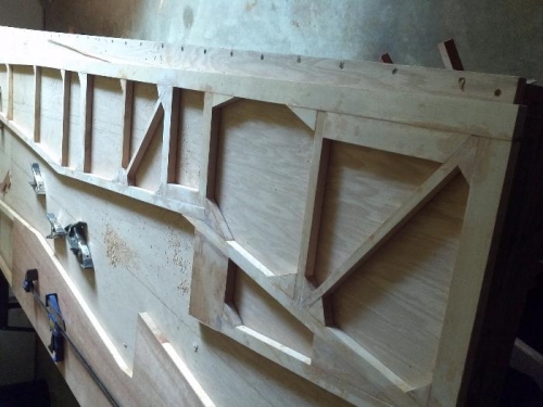

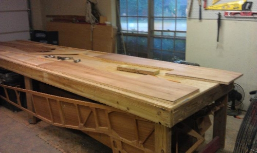

Cutting and fitting 3/32 Ply from Station 0 to 78
To provide Strength and support of the Forward Fuselage, each side is covered from Station 0 to Station 78 with 3/32 inch mahogany plywood on the inside face of each side.
