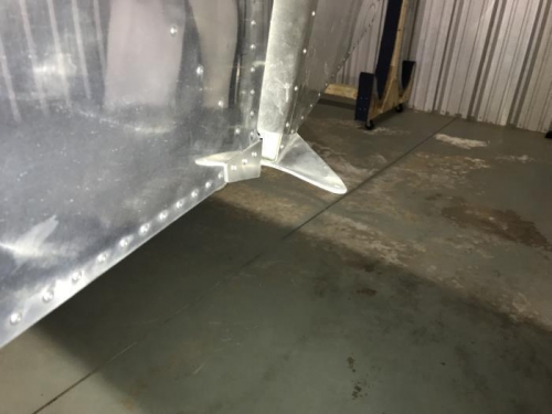

Finished up some more cleanup tasks from my 12 October Tech Counselor visit. The focus for this session was a complete cleanup of the tail section control horns. Specifically, my TA recommended I clean up the cut edges of the horns better to remove all signs of saw/router marks along the edges. So I started with files, worked my way through a couple of different standpaper grits (80, 120) and finished off with plumber's copper tube sanding strap (220) to end up with mirror edges on the control surfaces.
Upper elevator horn after filing and polishing.
Rudder horn after filing and polishing.
