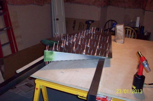

The reassembled rudder with rivets all ready to go.

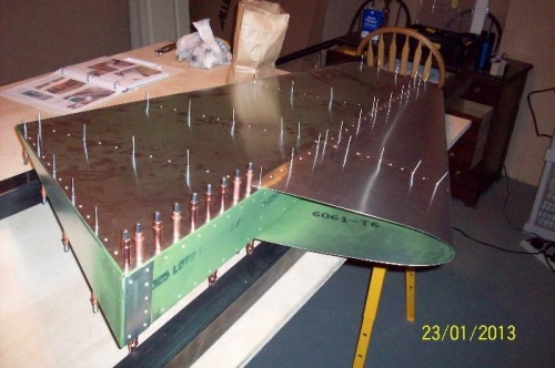

Almost finished with the first side.

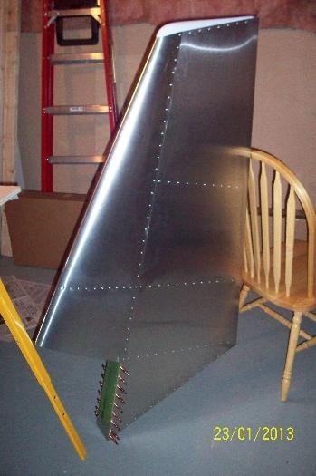

The completed rudder.  Very happy with the result.
