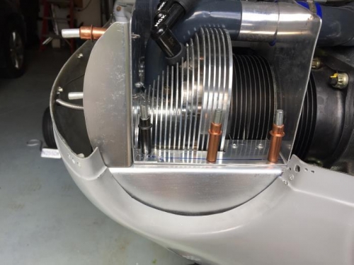

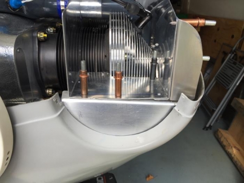

Today I finished off fitting the rest of the forward baffles.This includes the second bottom baffle on the right side and both side baffles. The trick to this was trimming the pieces so there's no excess metal behind the cowling, but so there's also no significant gaps around the air intake lips.
Left side bottom baffle and side baffle trimmed to fit and clecoed in place.
Right side bottom baffle and side baffle clecoed in place.
