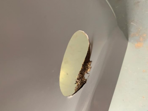

- Exhaust pipe opening was too small leading to scorching of the lower cowl during flight. Opening was ground out to a larger size.

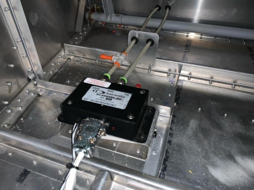

- ACTV ADAHRS VIBRATION caution light on Skyview system screen twice during flight. Riveted in 2 L-angles to stiffen the floor around the ADAHRS mount behind the cockpit area.
Ehaust pipe opening too small - caused some burning.

ADAHRS vibration caution led to floor stiffeners around ADAHRS.
