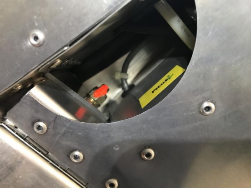

Changed out left wing aft spar attach bolt. Original bolt was too short and displayed too few threads past the nut when fully torqued. Purchased new bolts of the next size up and installed in their place. New bolts fit fine.
Left wing aft spar attach bolt. Proper excess threads showing with new longer bolt.
