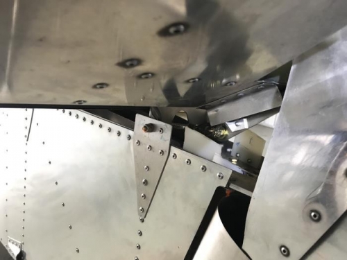

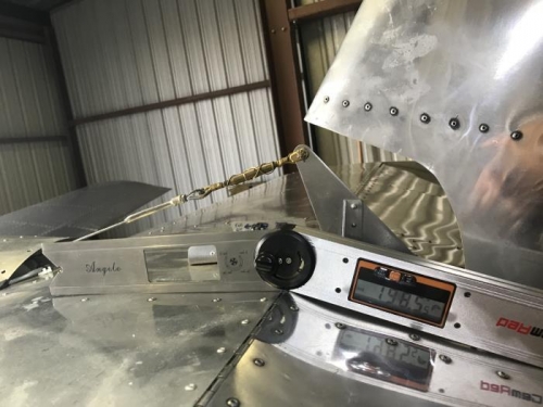

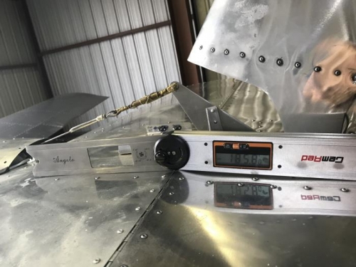

Elevator was not deflecting down to specification. Trimmed the lower elevator stops to meet spec. Down angle increased from 9 degrees to 13 degrees. (spec is 12-15 degrees down)
