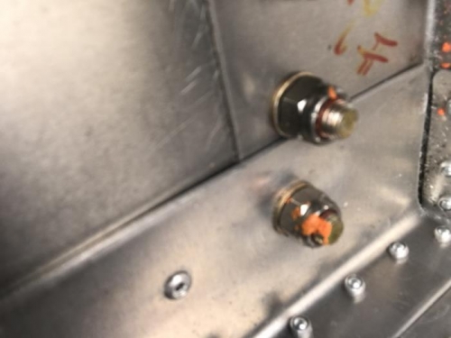

Brief Description:  Wing Attach Bolt Washer Fit
Had a washer spanning across 2 thicknesses for the middle, lower, left wing spar attach bolt causing it to deform. Replaced the washer with a new washer with one edge ground down to fit flush with the thicker metal piece.
Left wing attach bolt with ground-flat-edge washer installed.
