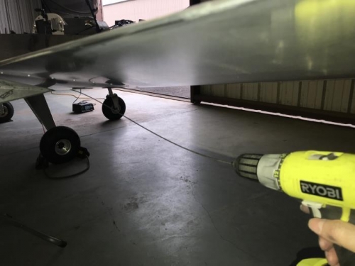

Lastly, I reinstalled the piano hinge pin by waxing the nearly 7-foot pin to lube it, chucking it into my drill bit, then feeding it through the two hinge pieces (flap and wing) by rotating the pin while pushing it in gently. This works like a champ!

Threading the waxed 7-foot hinge pin into the hinge using my drill.

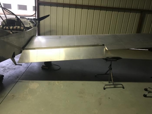

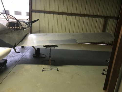

Flap in propped up in the retracted position.
Flap propped in the extended position.
